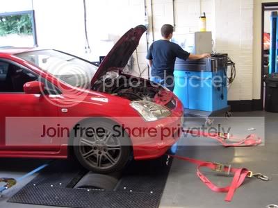

Conditions were very hot but that didn't matter as the dyno was a Dynojet and atmospheric conditions are taken into account. I believe this is the first dynojet in the country, it is only 3 months old. It also has the information for a/f ratios but i'll talk about that later.

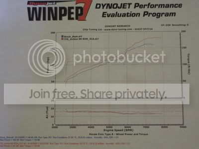

So with those little mods my car was tested 3 times and pulled an average of around (all figures are at the wheels and SAE corrected):
161bhp
122lb/ft
(there was one run where we think the dyno threw a wobbler as there is a massive spike in torque which was not apparaent in later runs)
We swapped the boxes over and got an average out of 5 runs:
175bhp
128lb/ft
The graphs show I gained around 10lb/ft at 3500rpm. There are increases at every point on the graph. In vtec there is a massive difference in both torque and power. From around 6500rpm all the way to the limiter the standard cars torque tails off slightly whereas the ITG fitted car maintains a stable torque curve. I'd say theres 8-9lb/ft increase in VTEC. Power just climbs and climbs til the limiter kicks in. On the standard car the power tended to level out at 7000rpm.

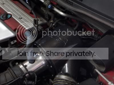

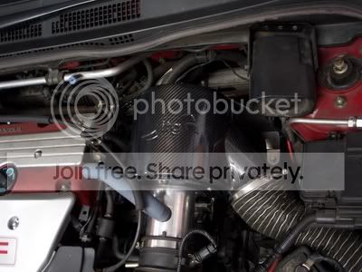

So right how does it look? F-ing gorgeous. I will upload pics tomorrow. Its also 2.5kg lighter over the stock box. Me and Andy (Stuarts right hand man) got the scales out. It fits like a damn glove I am not joking when Andy took about 5 minutes flat to swap the airboxes. And theres no gearbox linkage problems like there is on the Icebox or imo useless heatshields to fit like on the gruppem.

20bhp and 10lb/ft at the wheel increases. Thats madness. Graphs will be on the ITG website soon.
Oh one more thing... a/f ratios. In VTEC as stock the car runs stupidly rich. I think it was something like 11.0-11.5. The ITG leaned that one out quite well.

#826492
Err, no idea. Look at the pics when i upload them in a minute so you can see for yourself.

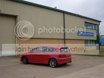

By Paul-CTR
#826505
pics?
By Paul-CTR
#826507
Last pic was Stuart Fedden - Main man at ITG and a very nice bloke

#826508
Now that does look the dogs danglies!!!
Cheers
AC :lol:
By Paul-CTR
#826512
Looks even better in the flesh dude. It does actually look like its worth the asking price!
