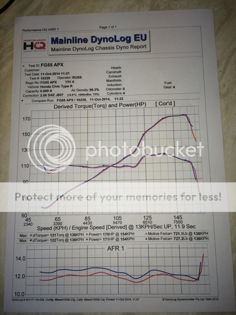

Had a rolling road day with my local club today. The graph shows whp and I was wondering roughly what the engine power would be. Also are these good figures for the mods I have?
Mods : teg m induction
HKS hi-power cat back
By Wullie_trd
#3801662
pulpmelon_r wrote:Did any stock civics run on the same dyno, if so what did they make at the wheels?
Unfortunatly not, there was a stock ap1 s2000, it got 169 @ the wheels.
The guy at the place estimated 220bhp for my car, I wouldn't have expected it to be that high with just an induction and cat back ???
By Wullie_trd
#3801683
Lewisgame wrote:That would be roughly 30ish percent drag which is a bit steep. I'd estimate around 200-210bhp.
That's the sort if figures I had in mind too. I thought 220 sounded a bit ambitious lol
