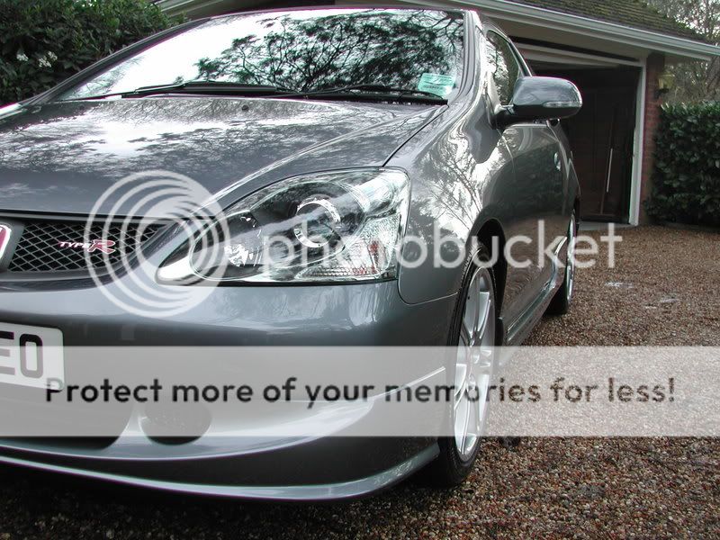

Here is my old car which has just been foamed using a karcher pressure washer and foam gun along with super snow foam:
