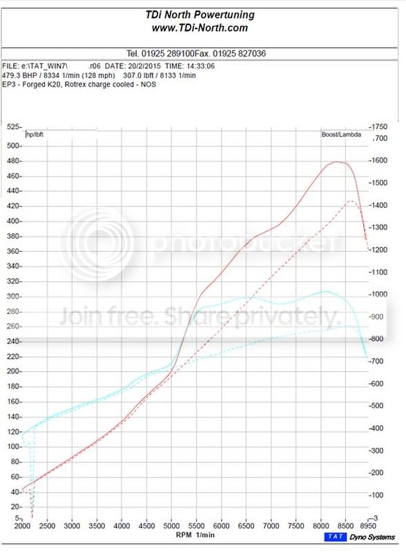

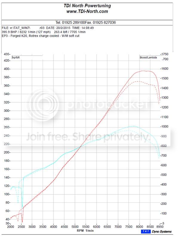

I very much doubt you'll get that boost pressure with that pulley.. I'm running my Rotrex flat out to achieve 1.35bar.. So around 89,000rpm. I think if you make a genuine 400hp with a 110mm pulley your doing pretty well.
