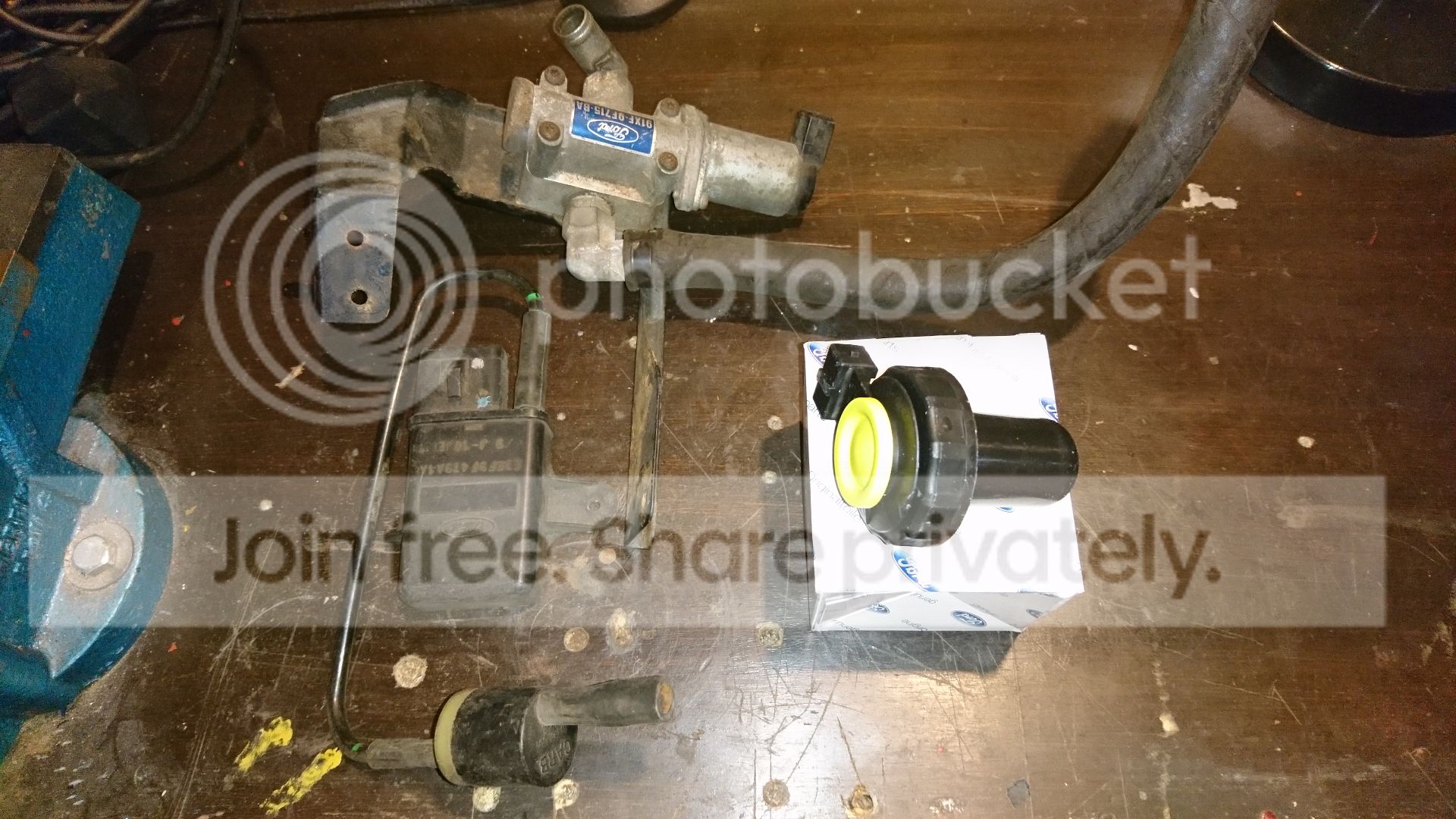

Remote idle speed control valve and new brake reservoir cap have arrived. Will get them fitted one night this week.
The holes are already in the inner wing, so that makes it easier. Hopefully my idle problems will be resolved and my brake fluid leak.  :)

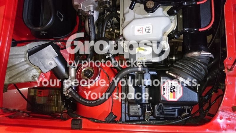

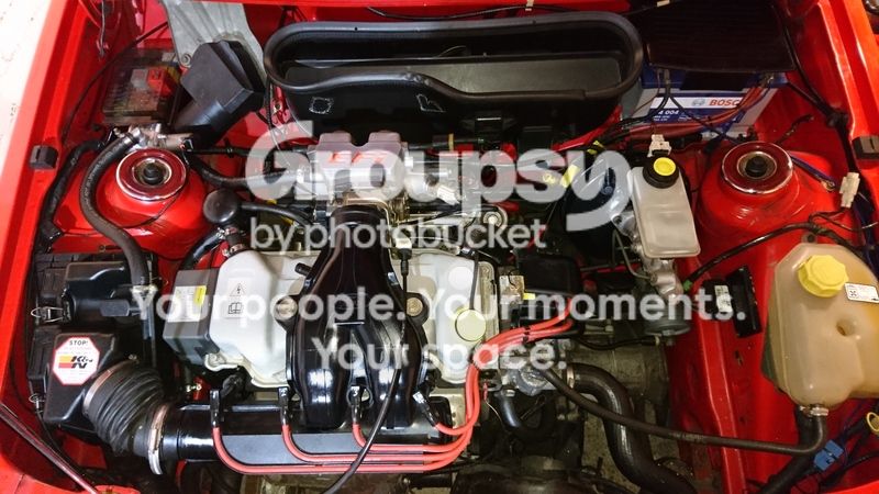

New reservoir cap fitted, and remote idle speed control valve fitted. :)
Set idle speed at 850rpm, returns back 850rpm after revving the engine. No stalling when dipping the clutch and idles loads better, smoother too. So all good so far. Just need to take it for a test drive after I finish call. :)

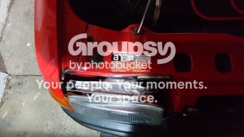

Exhaust clip from my MK4 with 1.6efi cvh with 2" bore down pipe back stainless steel exhaust.  :D
And the engine idling nicely after fitting the remote idle speed control valve. :)

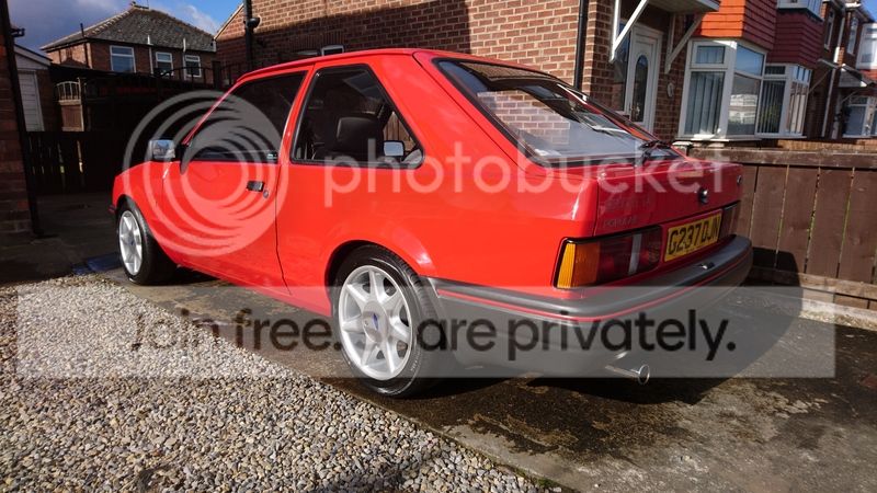

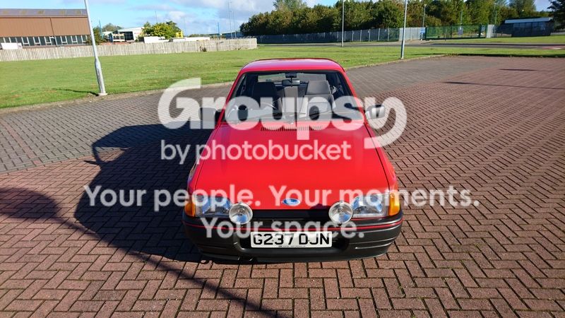

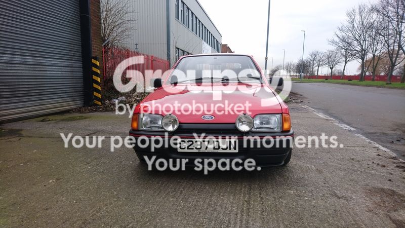

Some better pic's with the ambers fitted. :D

Collected a few parts today, correct airbox for the remote idle speed control valve I fitted. Genuine Ford Indicator to replace the aftermarket one I have fitted. And a coil pack cover that mine was missing. Just need a good clean before I fit them all. :)

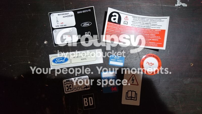

Changed my knackered under bonnet stickers today, but used ones for a 1.6 efi engine so they are correct. :)
Old ones
New ones
All fitted

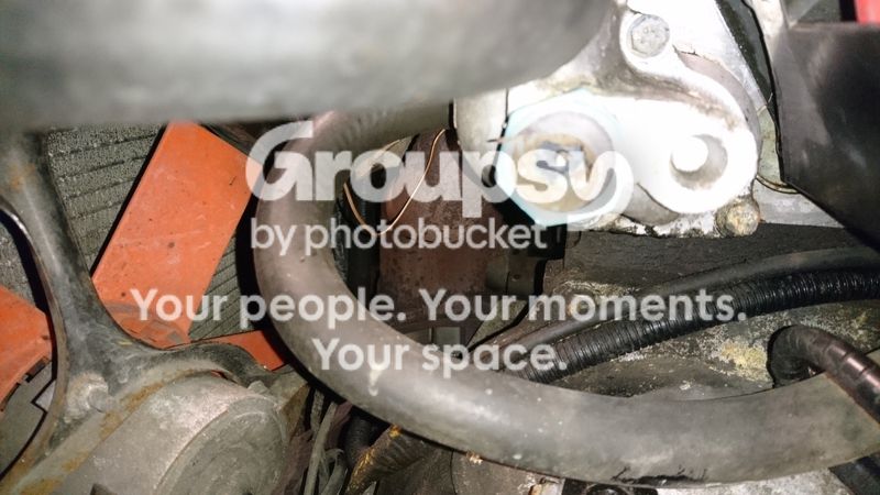

Got up to temperature, and fans didn't kick in. Done ecu reset procedure. Still no fan. Switched off engine, before it got to the red. So I could bridge the fan switch plug. And the fan switch fell apart in my hand. Checked fan still, and all working. Just need a new switch. :)
Think it's past its beat lol
By JC600
#3863299
New fan switch arrived. :D
Fitted
