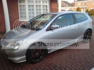

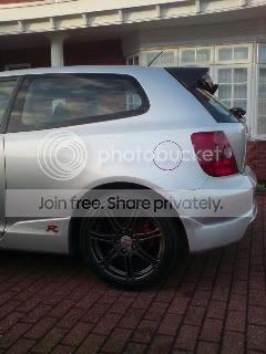

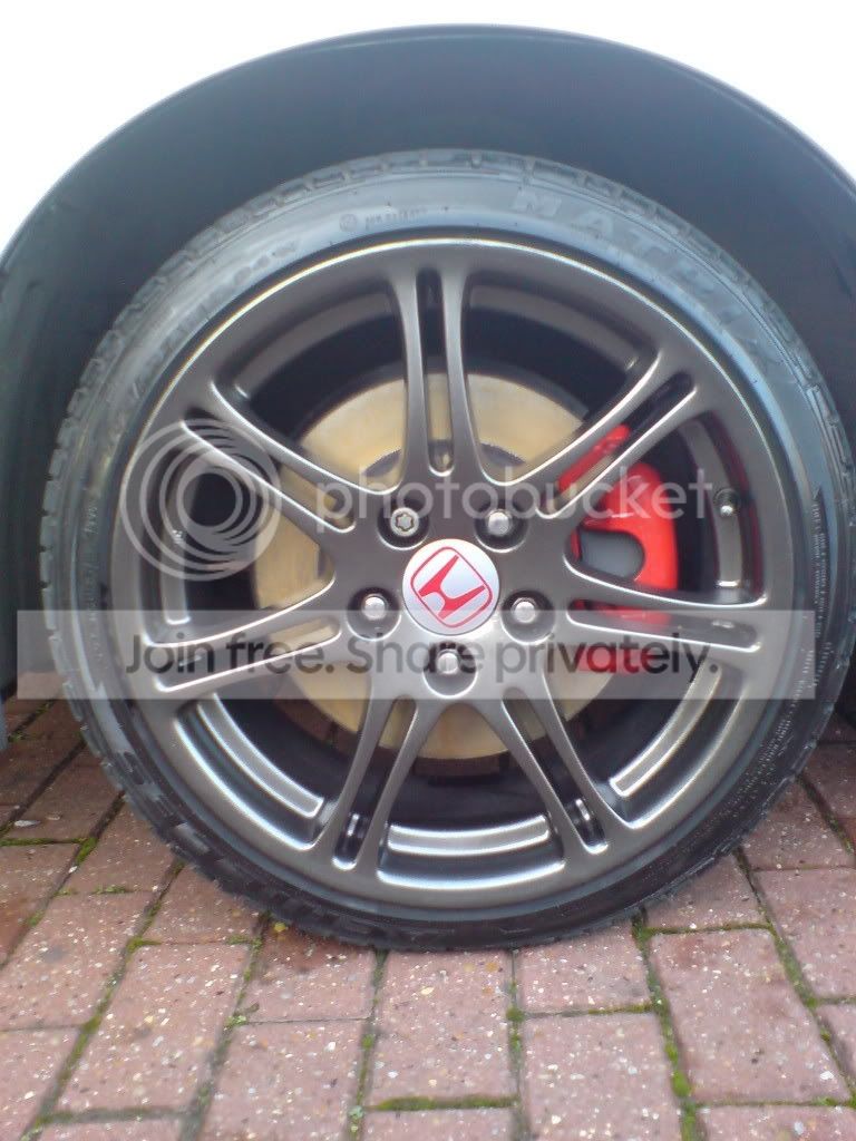

Right well ive been looking on the site and other places for what colour to go for on the wheels and to be honest i really wanted white but it looked :ymca: and dark wheels do look good on the sliver so,.............
looked at black wheels and to be honest i thought they looked a bit dripspeed (ripseep) off the shelf jobbie so went for honda graphite gray and the pics RLY RLY dont do them any justice cause it was done with a mob camara so shall take pics of them 2moro on car with a decent camara :thumbup:
But the wheel that was WELL flip (kurbed) came out a blinking treat :WOOT
I could not belive how well it work!!
but it is so so true the more effort put into the prep shows in the end product!!!
So for something that would of cost £220+ has cost me £35 and 2days work in no rush
Iam over the moon!!!!
(also found out the civic wheels are eneki's!)
going to get some coloured wheel nuts though...............
what colour peps???
red blue ....ect ect?

( Hello matt,
Well i sanded down past lacquer (a must!) and in places where the damage or peel was bad i just kept sanding till it went, (you have to get rid of all of it otherwise it will just peel ect again :thumbup: ) but smoothed around the area to make it blend as much as poss.
Dont worry too much as the high build primer will sort most of it out.
BUT after using the rough sand paper please please use the finer grade everywhere as if you DONT you WILL get a scratched effect :sad: so make sure you smooth the whole wheel with the finer grade sand paper.
Also for the inside's, yes i did spray them but as you will see that the orignal surface is quite rough so all i did was use the rough grade sand paper to get the old brake dust off and a light spray to blend it in but do lacquer it aswell,
also buy the hardest lacquer in a can you can,ive used high strength lacquer (which is totally completely fine!!) but i have just got a stone chip on one of my wheels :roll: so just buy hardest you can mate (if not then dont worry as iam sure it just my luck :roll: to get a stone chip on a wheel lol).
Also once you have done them and on car ect ect, when you come to wash you car+wheels for the first time since fitting your new wheels :WOOT
only use soapy water and NO alloy cleaning products if you can! because thats what causes these problems at the start :bad-words:
So if you can matt clean as regular as you can to keep them clean as a whistle :salut:
Hope this helps matt and if need anymore info then just ask :wink: )
